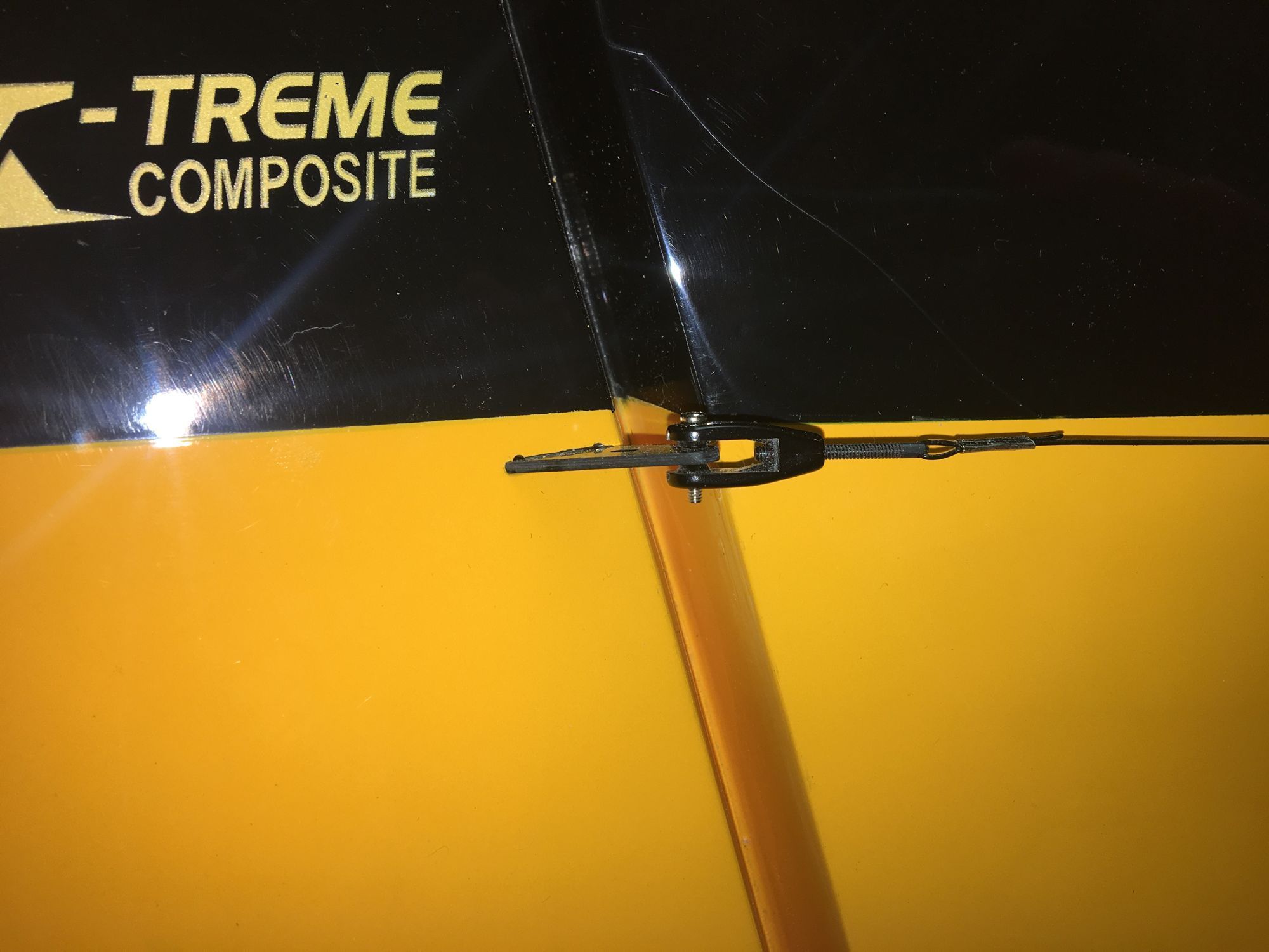

I wasn't happy with the clevis on the rudder horn as the hinge line is angled causing the horn only to be lined up with the cable at neutral. The connection was twisting so i swapped to ball links on the rudder horns.
