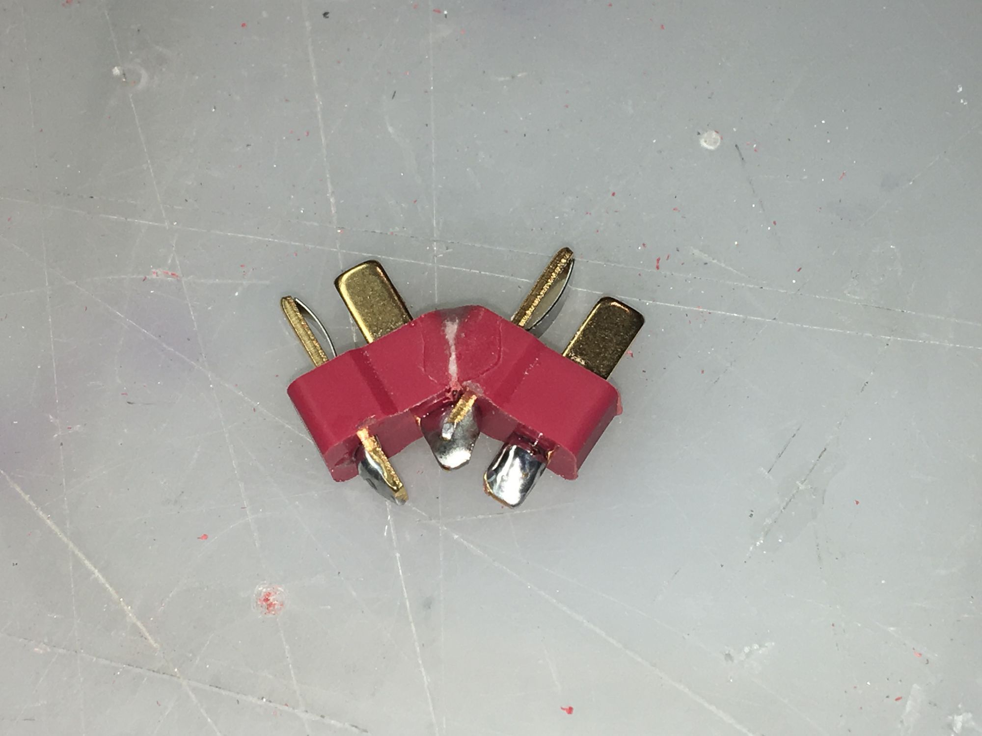

Probably the lightest way to make a series connector with 2 Deans connectors. The negative pole of one is soldered into a slot cut into the positive pole of the other. The plastic bodies are angled and glued together before soldering the two together.
